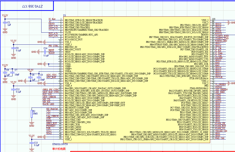

How is PB0/PC5 mapped as serial port pins?
Ok so STM32L158VDT6, a ten year old device, where PB0/PC5 are not associated with a U(S)ART on this or any L1 device.
So again perhaps some transposition, or software serial implementation, but a poor choice of pins even for that. Could perhaps use TIM3 to generate patterns.
A quick scan of some clone devices didn't yield any better fit.
If the use is intentional, perhaps a fishing exercise..

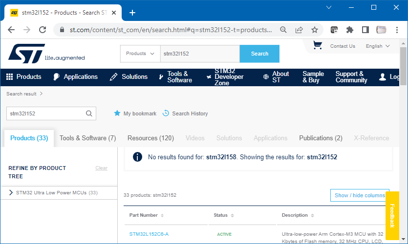

Are you sure about that part number?
Doesn't seem to be a catalogue part:

Hi @Hwei.2​ ,
the product you are asking about was never in distribution for end customer. May I ask where you got your samples(s)?

here is the datasheet. It should include the pin info you need.
More likely someone dyslexically transcribing the part#
Would suggest trying to determine what the schematic's author meant to write, and find THAT part.
