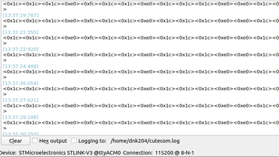

I am using a NUCLEO-STM32H753ZI-$AT3 development board.

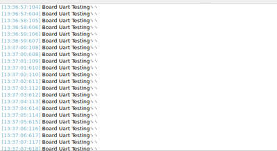

When I configure the MCU to use the internal clock (HSI), everything works correctly and my UART debug logs are printed normally.
However, when I switch to using the external 25 MHz clock (HSE), no UART logs are printed. The code runs,but the UART prints garbage characters, for example:
<0x1c><0xe0><0xfc><0x1c><0xe

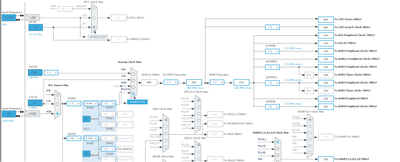

  • 25 MHz external clock is selected in CubeMX (HSE ON, Crystal/Ceramic Resonator).
  • PLL settings are unchanged except switching HSI → HSE.
  • UART baud rate is the same (115200).

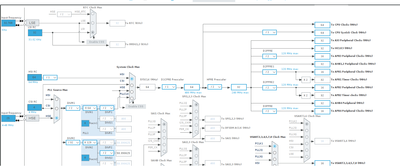

  • If I go back to internal HSI, UART prints again.
External clock ioc and log
Iternal clock ioc and log
You mean an external Crystal - not an external clock?
Have you checked that it is actually oscillating, and actually at 25MHz?
But the HSI is 64MHz - changing to a 25MHz source means that you do need to change your clock settings...

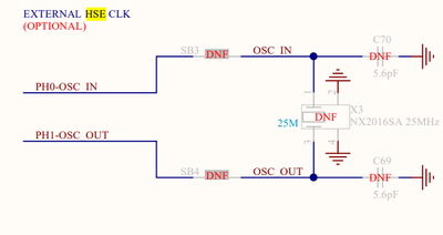

Hi @sameer_2k3,
Are you using an external HSE?  The NUCLEO-STM32H753 board does not have an HSE clock fitted.
 I think this may be the cause of your problem.

on NUCLEO-H753ZI board (MB1364), the STLINK has a crystal oscillator having a value of 25 MHz.
 How to use STLINK-V3 MCO output on Nucleo boards as a precise clock source for STM32 they already mention
Unless you have physically modified the board, you should select HSE bypass mode and change the value to 8 MHz. That is the clock signal coming in to OSC_IN on the target chip. The ST-link chip has a 25 MHz crystal but that is not relevant here.
