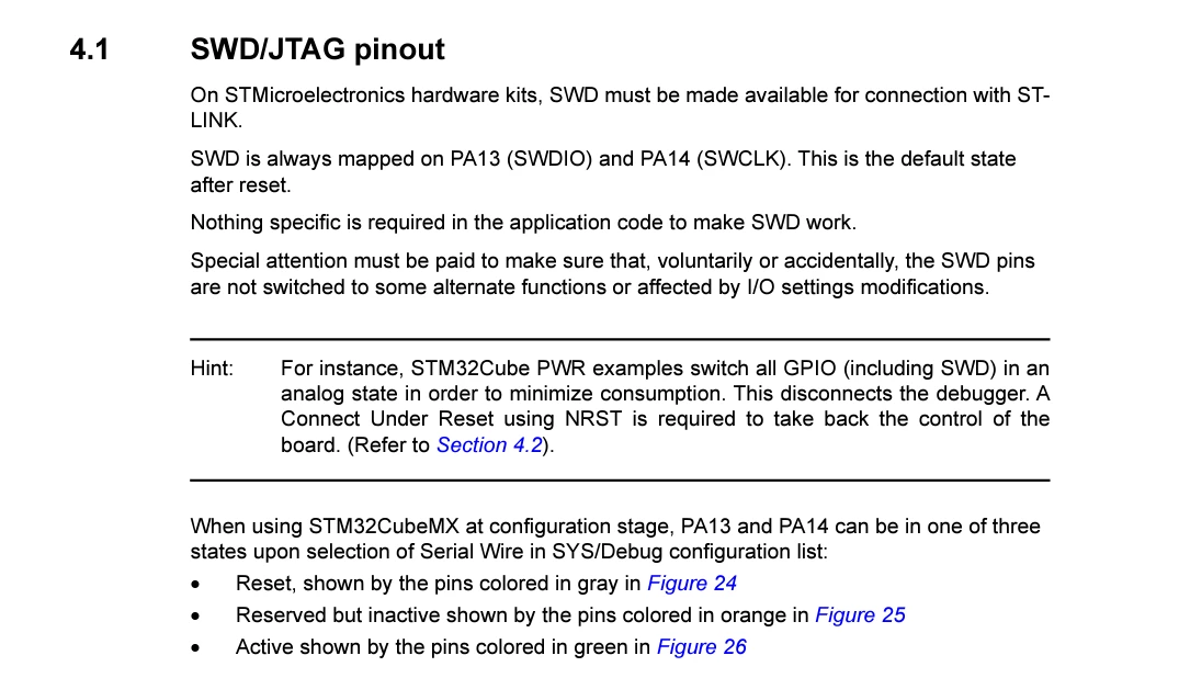

  • yes, SWD is the common/preferred method for programming and live debugging with the STM32CubeIDE debugging feature.
  • SWD is always mapped on PA13 (SWDIO) and PA14 (SWCLK). This is the default state after reset.
  • Yes,  SWD must be made available for connection with ST-LINK.
Please refer to the AN4989 section 4.1 to know all the details
Hope that helps!

Thank you for the reply. So to confirm, based on this document:
  • I only need to enable PA13/PA14 to program/debug the board? I do not need PB3 or NRST?0693W00000Y92JsQAJ.png

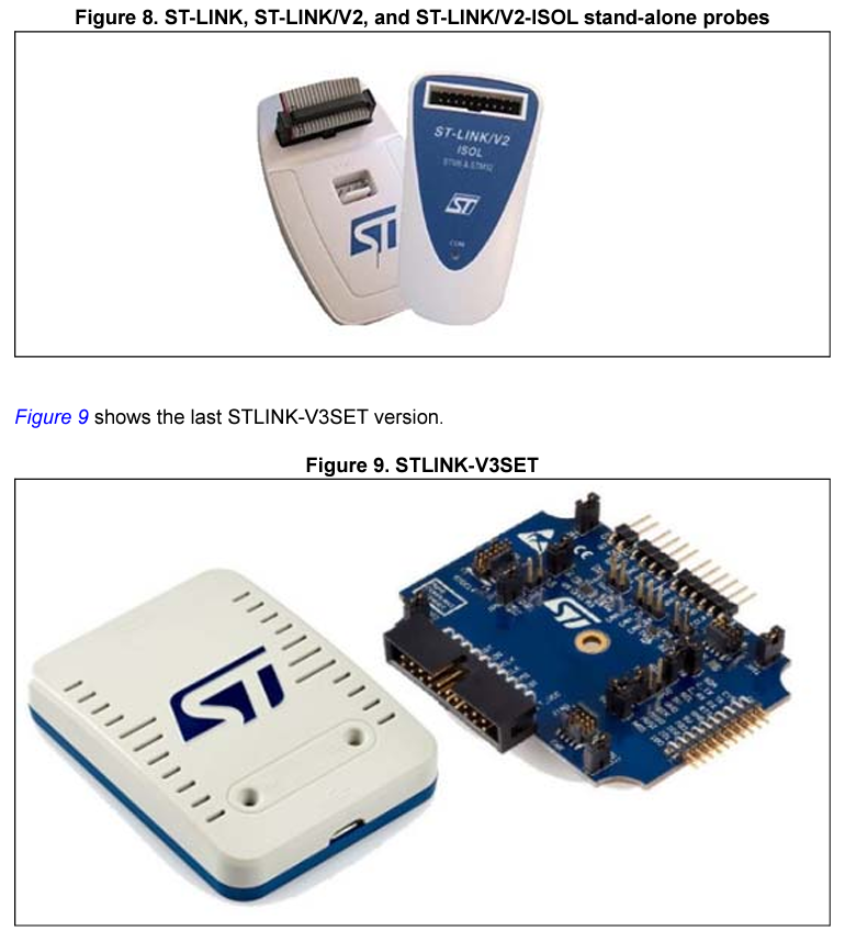

  • From that document, I see two recommended products. See the picture below. Will any of those work, or does it have to be a specific one?0693W00000Y92MSQAZ.png

NRST can be useful for some programming modes e.g. when you brick your MCU... Cube programmer has a mode "Under reset".
PB3=SWO is a debug tool: high speed UART like output. It is not mandatory but if you have this pin unused it may be worth routing it.

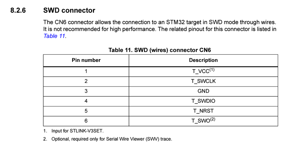

  • In the ST-LINKV3SET, I found the pinout for the SWD, but it doesn't mention what connector is used (1.27mm pitch header, 2.54mm, etc.). Where can I find this information?

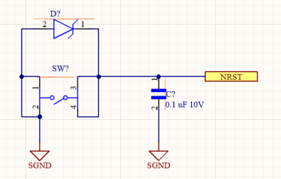

  • For the T_NRST pin, is it pulled to GND like it's done on the evaluation boards? If so, I could keep the push button on my PCB and use the hardware connection under reset feature, correct? (I attached a schematic of my NRST portion on my PCB for reference)

For the ST_LINKV3SET the natural connector to use is the CN1 (STDC14). Look at the manual chapter 9:
STDC14 connector (1.27 mm pitch) on target application: pinout detailed in Table 6. Reference Samtec FFSD-07-D-05.90-01-N-R
(The CN6 is obviously a 0.1" header).
The NRST pin is not pulled down. It is pulled up by an MCU internal pull up, and set to ground to activate the reset. You can keep the button for manual reset and also connect the reset pin to the debug connector.

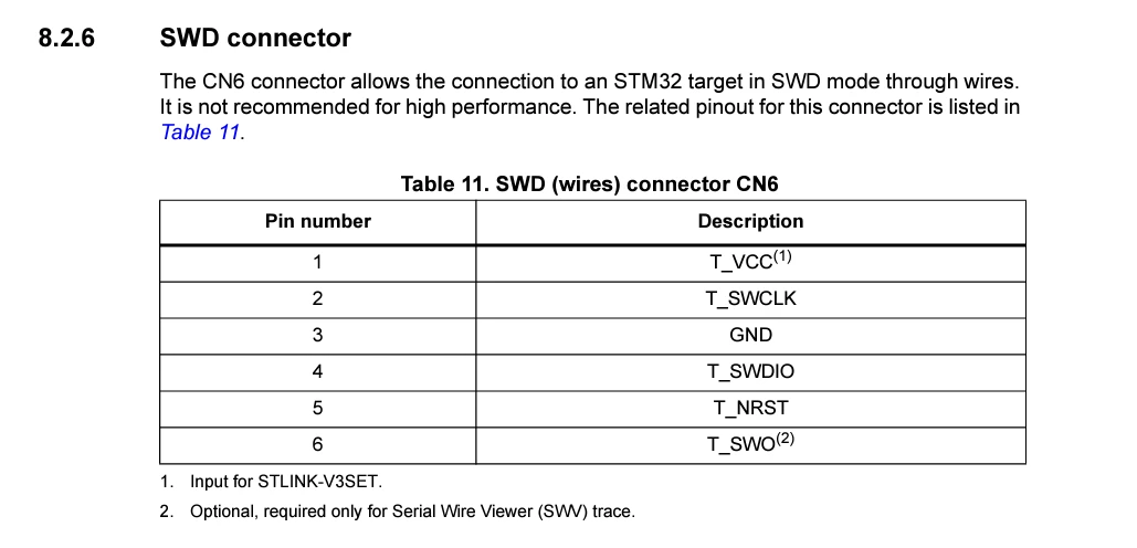

I am looking to optimize space on this board, so having to have a header connector on my board with that many pins will be problematic (This board is fitting in a tight space). That is why I was leaning towards CN6 and then just strictly use SWD.
When you say obviously CN6 is a 0.1" header, where are you basing your information off of? If that is the case, then that's preferred because I can more easily integrate the 0.1" pitch wire harnesses in our lab.
