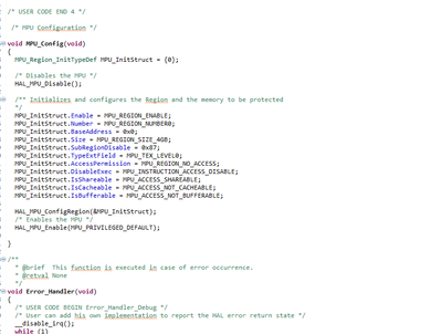

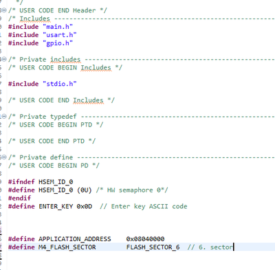

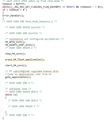

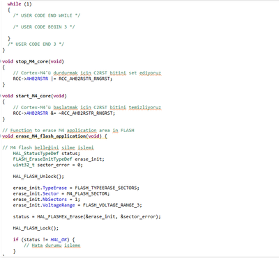

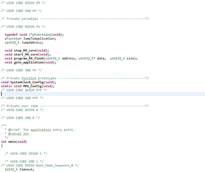

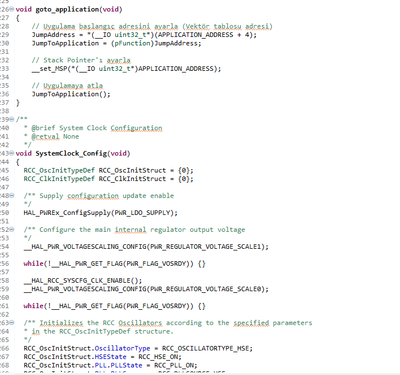

First of all, I would like you to leave the discussion aspect. I think such a suggestion should not be a problem on a platform where many people share the github link and this is normal.

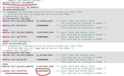

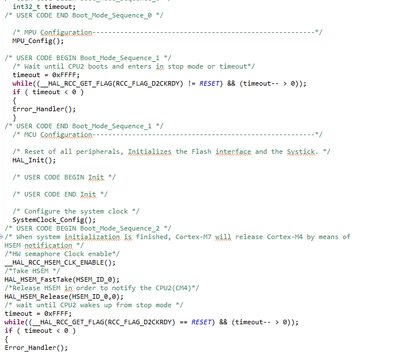

To make the issue clearer, the FLASH linker of my application code is below for m4 and m7. My application code is LED blink running on m7. Configurations and bootloader code are below. The problem is that it cannot jump to the application code.
M4:
M7: I reserved 0x40000 space for the bootloader.
The bootloader code is below.
In my application code, I gave vector offset for m7.
‎2024-07-16 5:24 AM
Your bootloader is running on the M7, right?
It stops the M4 core, erases the M4 code, restarts the M4 core, and then it jumps to the M4 application that it just flash? That doesn't make sense. The M7 core can't run the M4 code.
‎2024-07-16 5:42 AM
Yes, bootloader m7 also works. Application code also works on m7.
Even if I call the goto_application() function directly without stopping the M4 core, deleting the M4 core and restarting the M4 core, the bootloader does not work.
This was the bootloader I wanted to develop as the first step. If this worked, I would develop a bootloader for my application code on both m7 and m4.
