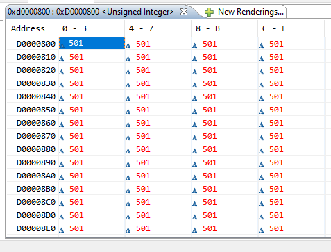

On writing a single 32bit value to 0xD0000800 memory location. instead of getting a value at that particular memory location the whole memory got updated with a wrong value. below is the screenshot of the memory Browser in which i tried to write 1 to 0xD0000800.

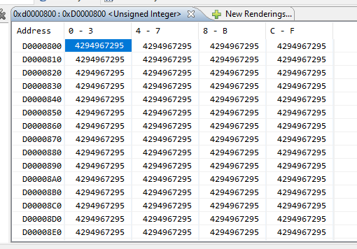

0693W00000ANwOMQA1.pngand On reading the same memory location the complete memory shows 0xFFFFFFF/4,294,967,295. below is the Screenshot of the memory browser.

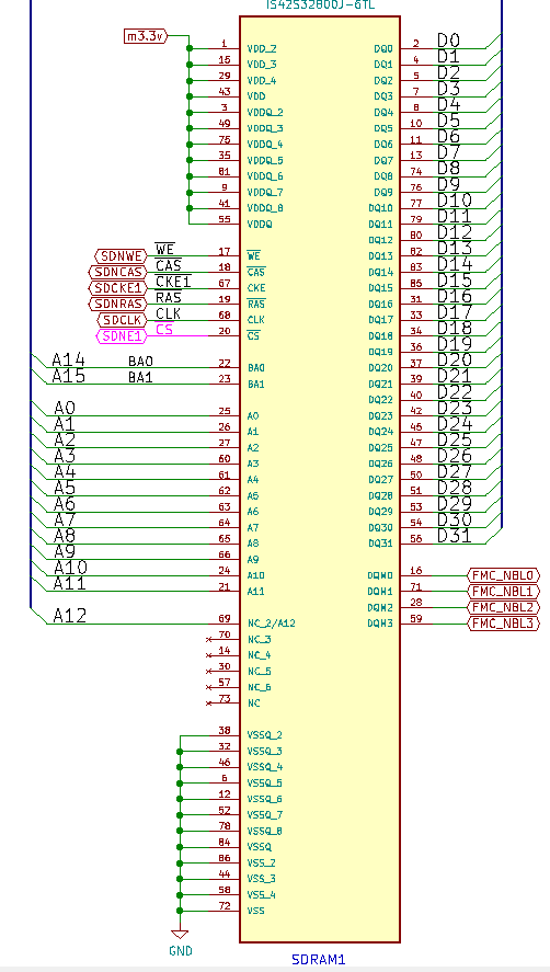

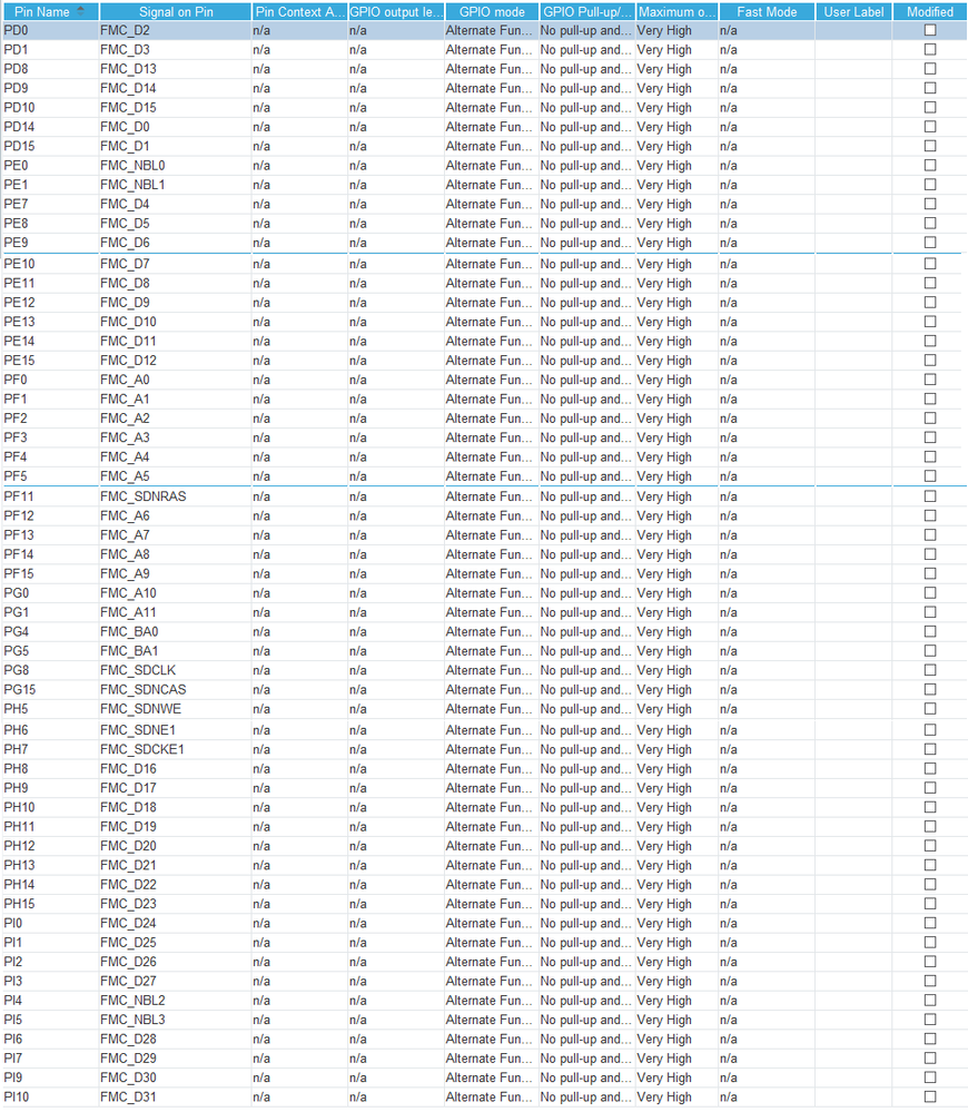

Below is the schematic of the SDRAM and MCU pinouts

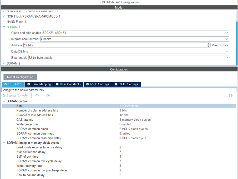

0693W00000ANwPoQAL.png0693W00000ANwQ8QAL.pngand below is the SDRAM configuration
