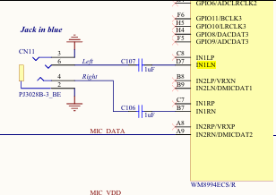

I would like to read the level of audio input signal to use like a vu-meter instead of use analog input.
This is my code but I read always 0dB on both channels.

aciuf
The problem could be on the evaluation board because the line input is a mic input, so probably I saturate the input with my signal.
I will check tomorrow if this is true.
I have modified the source WM8994.c to exclude the +30dB gain on input
Now the my signal does not saturate the input but still strange output:
input
   0dB  1.349Vrms   ->   on lcd read  -1dB
 -3dB   0.97Vrms    ->   on lcd read   -7dB
-10dB   0.43Vrms    ->   on lcd read -35dB
disconnected signal on lcd read -96dB
Do I have to apply a conversion to the smr_dynamic_param value ? because in the example there is a * 0.25.
    case INPUT_DEVICE_INPUT_LINE_1 :
    	BSP_LCD_DisplayStringAt(10, 80, (uint8_t *)"--INPUT_DEVICE_INPUT_LINE_1--", 0);
      /* IN1LN_TO_IN1L, IN1LP_TO_VMID, IN1RN_TO_IN1R, IN1RP_TO_VMID */
      // 0x0011 = 00010001
      //             |   +- IN1RN_TO_IN1R
      //             +-- IN1LN_TO_IN1L
      counter += CODEC_IO_Write(DeviceAddr, 0x28, 0x0011);
      /* Disable mute on IN1L_TO_MIXINL and +30dB on IN1L PGA output */
      //counter += CODEC_IO_Write(DeviceAddr, 0x29, 0x0035);
      // 0x0035 = 00110101
      //               +++  0dB
      //             + +30dB
      //            + unmute IN1L
      // 0x0025 = 001000101
      //               +++  0dB
      //             +-- 0dB
      //            +--- unmute IN1L
      counter += CODEC_IO_Write(DeviceAddr, 0x29, 0x0025);
      /* Disable mute on IN1R_TO_MIXINL, Gain = +30dB */
      counter += CODEC_IO_Write(DeviceAddr, 0x2A, 0x0025);
