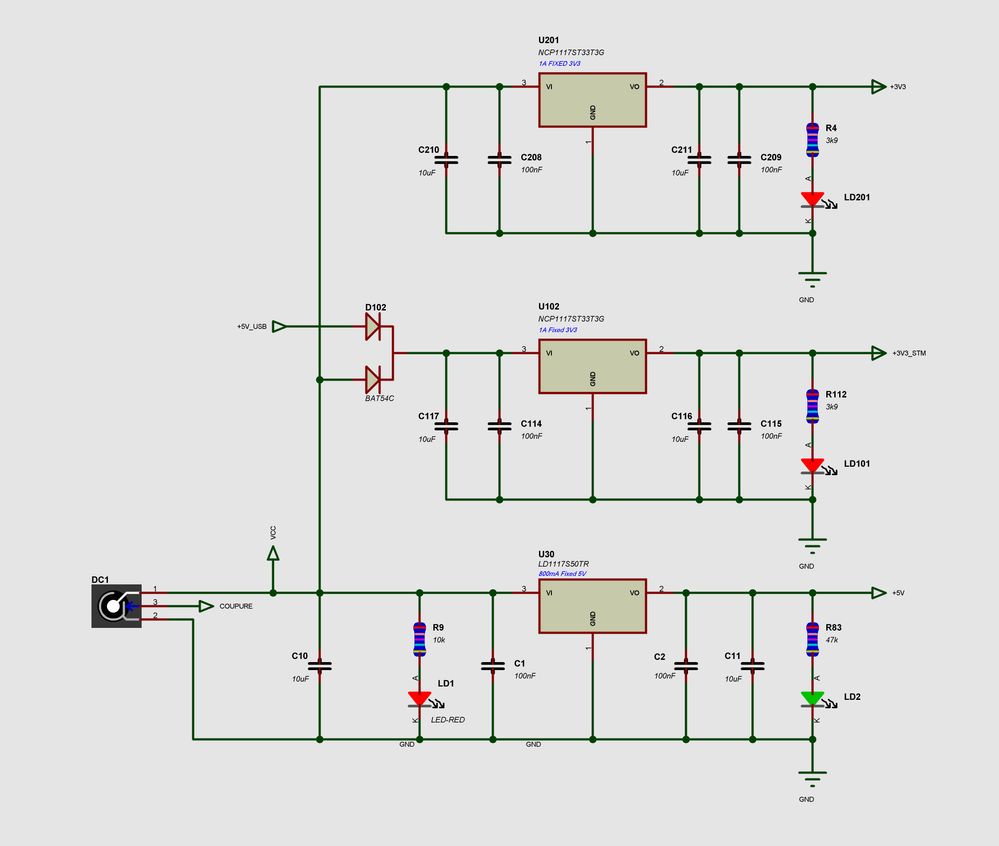

Where does the 3.3 voltages comes ? If from usb, then test so it is present before usb is plugged to pc. In some cases order of power up - usb plugging has been vital.

The usb provides the 5V and then a voltage regulator is in charge of lowering the voltage to 3.3V. I join you the shema of the power supply.
