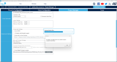

When I try to generate code from stm32cubemx v6.4.0. I'm getting an error message like "The Eclipsec execution launcher was unable to locate its companion share library.". I'm attaching the screen shot here
How to resolve this issue

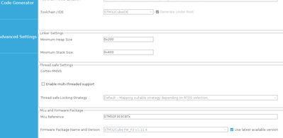

you changed settings for code.gen. ? ( + gen. under root , set it.)
see mine:

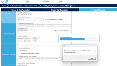

Yes, I changed the settings as I followed the instructions provided on the MathWorks website. You can find the relevant instructions here: Getting Started with STM32CubeMX.

Try my setting... + gen. under root , set it.
Yeah, but still I'm getting same error
Come on - you set : do not generate main.
So what should it do then .. ?  generate a lib ?
error: cannot find... -> So set the path to where the lib is, or leave it at the setting, Cube made as default.
I simply followed these instructions. You can find the relevant instructions here: https://in.mathworks.com/help/ecoder/stmicroelectronicsstm32f4discovery/ug/Getting-started-stm32cubemx.htmlakhilk_0-1721987005652.png

I had this issue on MacOS. Solved it by downgrading to a previous CubeMX version.
