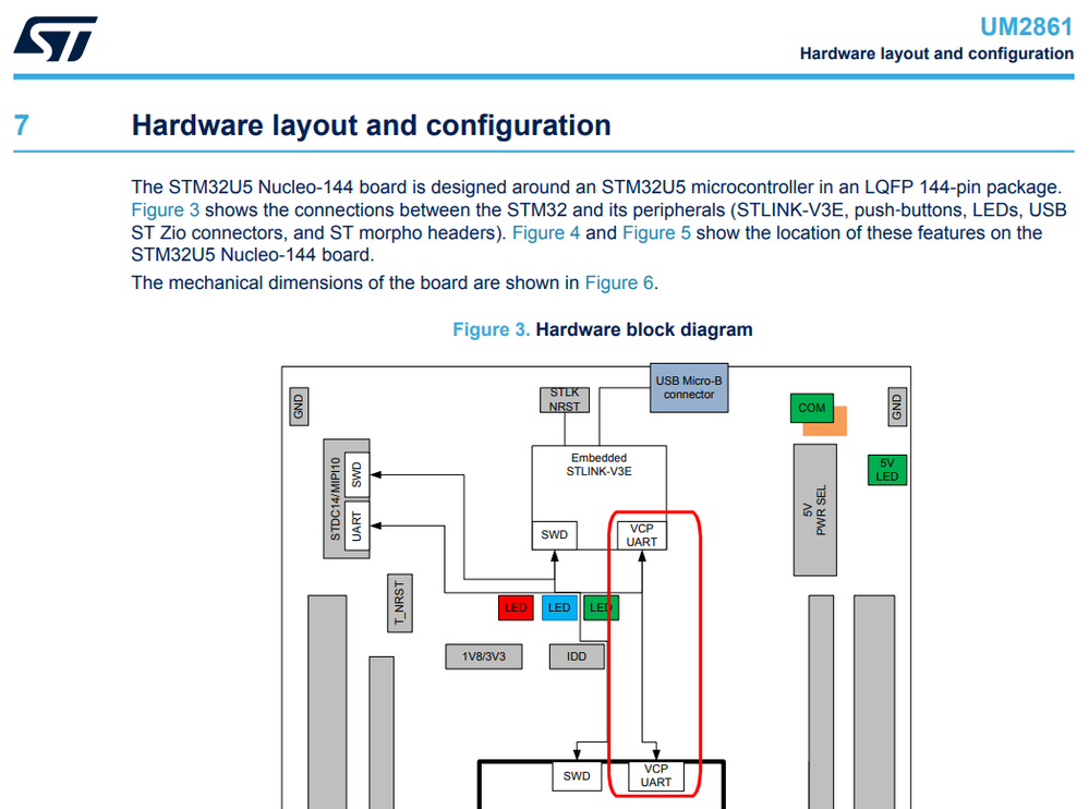

Hello everyone, I am having a problem with a simple program. My board is a STM32-U575ZITxQ.
Using only the USART1 interface, if I try to print the string: "USART1_READY" on my laptop's serial port, I have no problem. However, as soon as I also enable the USART2, I cannot print anything. Whether with only the USART2 enabled, or with both USART1 and USART2 enabled, if I try to print the string with USART2, I cannot. I checked all the settings of the USART1 and USART2 and they are the same (in GPIO, in Parameter setting, etc.).

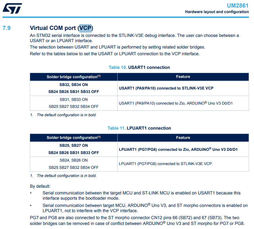

@SMusc.1 wrote:
 VCP is the com serial port of laptop right?
"VCP" = Virtual COM Port - it is part of the ST-Link on the board:
https://www.st.com/resource/en/user_manual/um2861-stm32u5-nucleo144-board-mb1549-stmicroelectronics.pdf#page=10
via: https://www.st.com/en/evaluation-tools/nucleo-u575zi-q.html#documentation
I am using a simple USB cable connected to USB port of my laptop tho the board. I see that the port com associate to this connection is any time COM4. How can i know which com port are used from USART2 and USART3 of my nucleo board?
That is the VCP of the ST-Link - see my previous post
There is no other COM port.
If you want additional COM ports to connect to those UARTs, you will need to provide them yourself; eg, using  USB-to-UART adaptors or cables
