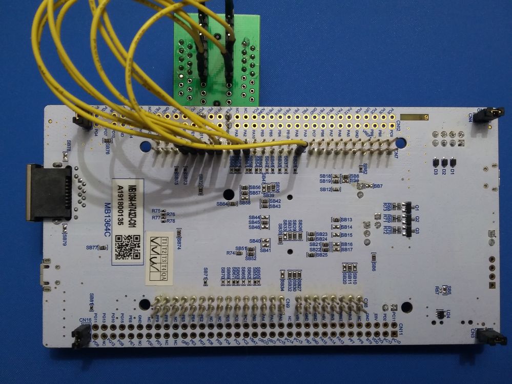

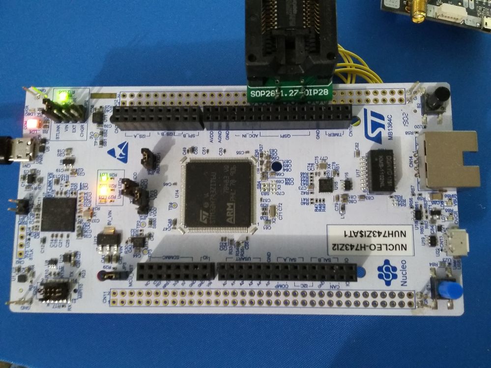

B166ER
hello,
I have tested your image on three different H743ZI2 boards, but I never receive any message on the VCP.
the LEDs are blinking however.
all other STM boards I have give me output over the VCP.
this is crazy... I am thinking if all three boards are broken...... but this is highly unlikely
do you have a picture of your board of FRONT and BACK ?
I want to compare the solder bridges and so on if there is any physical difference.
kind regards
Will see what I can do.
SB5 and SB6 should be ON, SB4 and SB7 OFF
Jumpered for 3.3V operation JP5
Rev C board
Will see if I can get the angle, focus, lighting better
Alternate would be LPUART1 via SB8, SB9, SB18 and SB12, SB34, SB66, SB18
There is some flux near SB7, suggesting it might have been removed (not by me)
SB5 looks OFF, so using the level shifter.
Do you have a shield plugged in?
SB12 and SB19 should be ON signals at chip
SB3 SB4 OFF
SB18 SB66 OFF
SB8 SB68 ON
SB9 SB34 OFF
