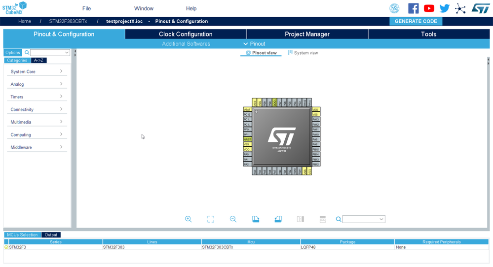

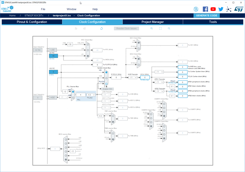

I might be missing crucial info since I don't know where I should be looking to solve this error. Here are some extra screenshots of the cubeMX configuration.

Flash wait states? Clocks or PLL not starting? Errors returned, helpful infinite loops? ​
I don't know how to read/change these values and states. Aren't the default values ok for normal operations?
