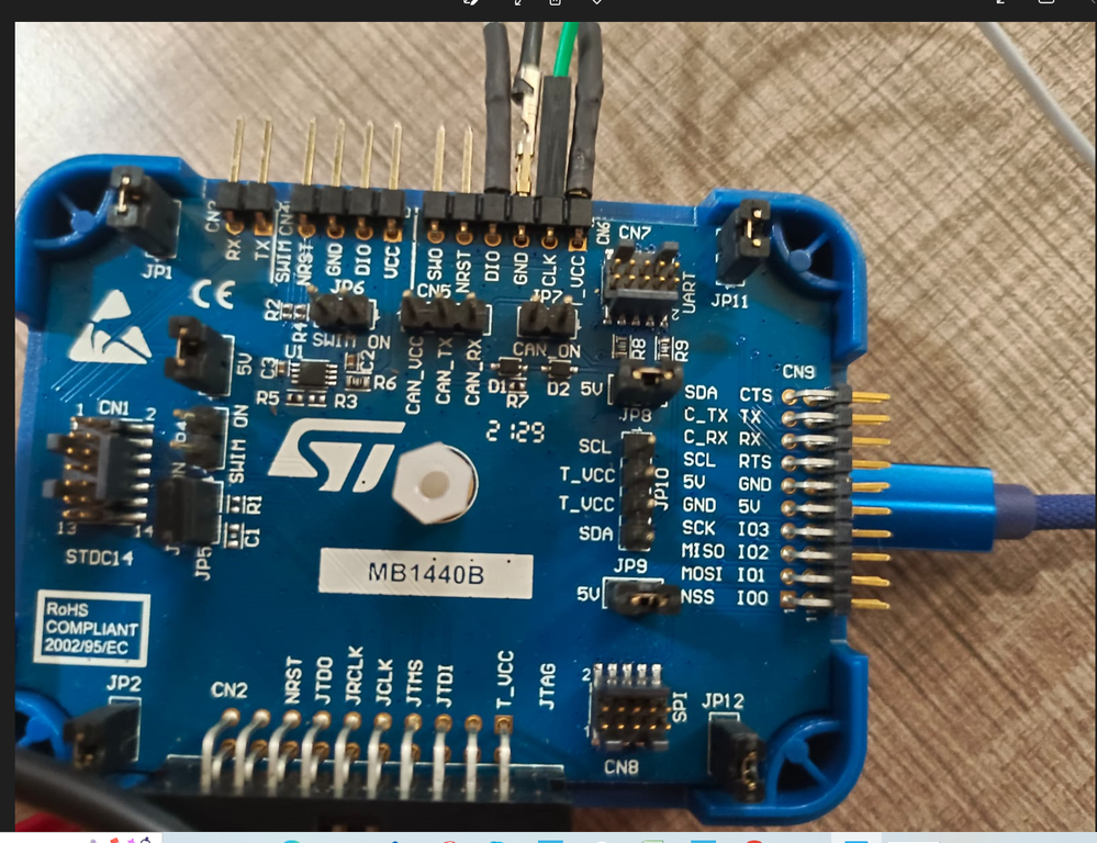

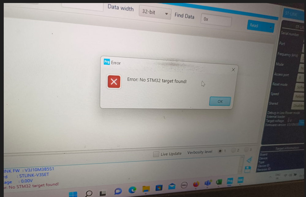

I am working STM32H745 controller. I am trying to connect STLINK_V3 SET to my custom
board. But I getting the errors I am attaching the images ,I set the Debug as serial wire and device is in Connect Under Reset. What things I have to check, also I check the USB cable .Can you please help me.

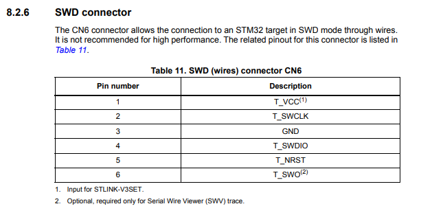

I notice on the second image that your T_NRST is not connected, if you refer to the User Manual UM2448 Rev7 "Section 8.2.6 SWD Connector" these are the required pins for a SWD connection

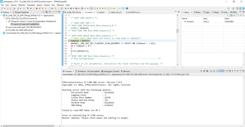

We also connect the NRST pin but its shows the same result. When we make the BOOT0 high on power up and release that pin then it shows in in cubeprogrammer device is get detected then temporary coding is done .When we try after some time and try to code again shows the same error. Also when we try to programming in STM32CUBE IDE Cortex M7 programming is done and when we try to programming to cortex M4 is again shows GDB sesver error. I am sharing the schematic file and the images ,please check that, I stuck here , what things I have to check ?

When we try to programming through the STM32CUBEPROGRAMMER it shows the programming is done successfully but programming is not done . And when we try o programming through STM32CUBEIDE the core M7 programming is done successfully and after we programming the core M4 it gets stuck. 0693W00000Unu6wQAB.pngWhy these happing, i need your support. Please help me. We use the SWD interface.
