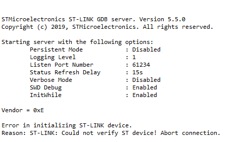

Hello;
Can anyone run STLINK V3 with CubeIDE? I can delete and load the hex code inside the processor using STLINK_Cube Programmer.But when I try to enter debug through CubeIDE, I get the following error. Anyone who has encountered this error and can find a solution?0693W000001qqc5QAA.png

Thank you for answer. I solved the problem. I guess you shouldn't leave the frequency setting on auto. I do not know if it is a special case for the processor series I use. I had to set the frequency setting to 8000 for the F1 family.

Works for me. Make sure it's not open in another application. Using a BluePill? Wouldn't be surprised if that was the source of the problem.
