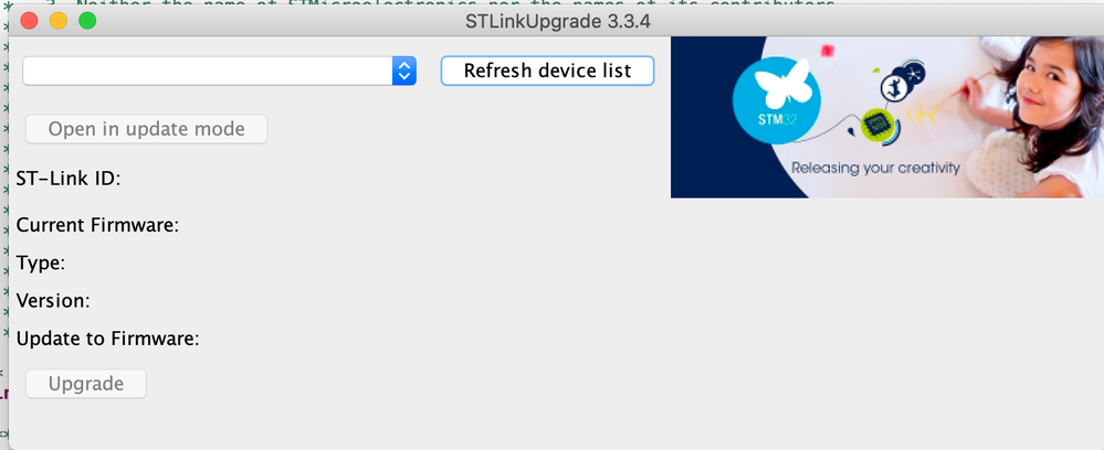

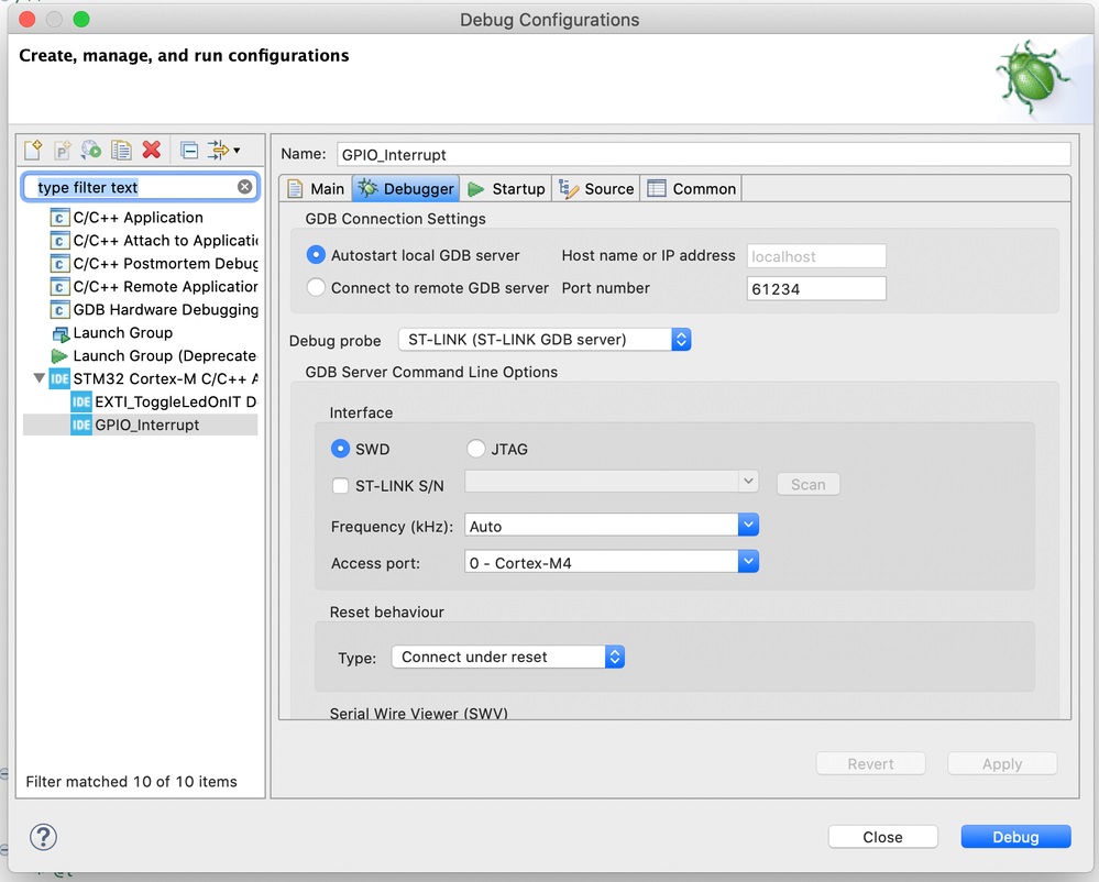

I am trying to program a STM32F411E-DISCO with a new MacBook Pro. I installed STLink and then I installed the IDE. When I try to debug, the IDE says no STLink is detected.
Here is a screenshot of my debug config.
Here is a screenshot of the STLink Upgrade window

The board has two USB ports. Make sure you're using the correct one (CN1), which is a USB-mini, not a micro. Make sure you're not using a charging cable.

Thank you for your quick reply!
I am sure I am connected to the correct port.
How can I determine if I am using a charging cable rather than a data cable?

You must install the Ide with the 1.4.0 installer (not from an update of a previous version), it should then install STLinkServer and if STlinkServer is installed correctly, it should work.
Did you have an error installing STLinkServer application ?

Well as it turns out, @TDK​ was correct. I had a charging cable...or maybe a bad cable. When I changed it, everything started working. Thank you both for helping me!
