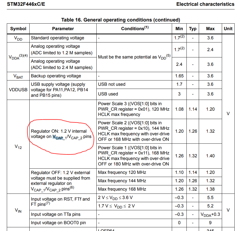

Flashing fails, I'd probably double check the supplies, and voltage / capacitors present on the VCAP pins.
fabocode
I tested the supplies, my custom board receives 12VDC and then is converted to 3.3V for the STM32. This is expected
Checked the supplies and I'm getting 3.3VDC in the SWD lines.
in VCAP_1 pin I measured 1.32 VDC.
Reviewed the STM32F446 datasheet but I am not actually understanding it well, but I guess the VCAP values are good.

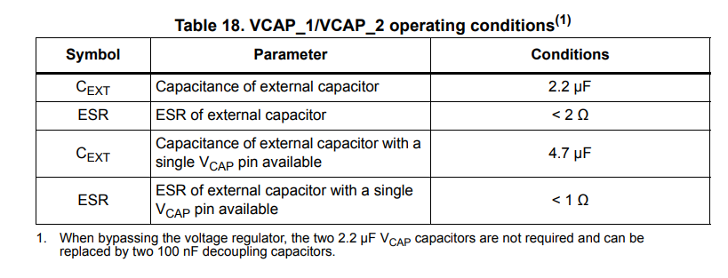

However, I've found in the schematics that the VCAP uses a capacitor in my custom board:
GRM31CR61E476ME44L which looks like it is 47uF and it should be of 4.7uF . Not sure if this should be something interesting to look and if there is a way to solve the issue. 0693W000003PC47QAG.png
Is it possible damaged? I'm honestly getting without options.:sad_but_relieved_face:
Replace the capacitor(s) with appropriate value
I don't think the wrong VCAP here will cause permanent damage.
