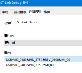

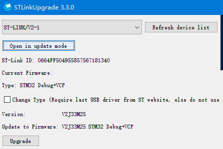

My board is NUCLEO-H743ZI. I change the ST-LINK type from STM32 Debug+Mass storage+VCP to STM32 Debug+VCP.

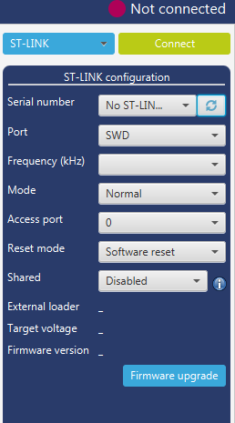

But after the change STM32CubeProgrammer can not detect the ST-LINK.
It might be a hardware ID issue?
The usb pid of STM32 Debug+Mass storage+VCP is 374B.
STM32 Debug+VCP is 3752.

It seems STM32_Programmer_CLI v2.0.0 works fine.
