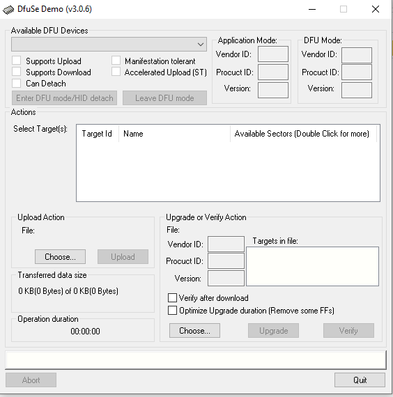

I downloaded that package (en.stsw-stm32080) under Windows 10 and it comes up with not finding a device (I had BOOT0 strapped to Vdd)
Board would need powering, you'd have to see the device in Device Manager

Connected CN1 to USB (to power the board)
Connected CN5 to other USB port (left out HUB since it might cause mess). LD7 goes lit.
But no USB device is generated or detected.
BOOT0 is jumpered to VDD.
BOOT1 (PB2) - No jumper
CN3 Jumpers now in place. Tried also with Jumpers off to no avail.
