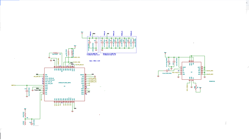

Current consumption is high in Standby ( 500uA to 1ma)
Pkuma.21
I have been working in Lower devices ( STM32L0),
Using 1MHZ Clock. ( MSI)
I m using Standy Mode to reduce current consumption when i am not using controller. In Standby mode with accelerometer i am expecting 37uA current but sometimes it is consuming 500 uA to 1 ma.
I Suspect 3 things,
1) capacitors , started to reduce the capacitors in VCC line( removed C5,C6,C7,C8,C9,C10,C33 ,C34 ) and kept C19 as 4.7ua and C32 as 0.1ua near vddio2 pin after that in some devices the problem solved but after some days if i measure the same devices , the problem exits. (Capacitor details i have attached in circuit diagram)
2) In some devices in standby LED is glowing (Mildly), So i thought some clock is ON in Standby So i Started disabling all clocks while going to standby and when i disabled APB2 Clock current consumption Reduces by 150uA.
3) When i have go through some websites , there preferred to give different power suppy to VDD and VDDA pin. So , i pulled the VDDA pin off and gave 2.9v separately and found current consumption is reduced in some devices.

All I can suggest is that try a bare board with just the micro and minimum required passive components. Capacitors are usually not a problem unless they are leaking (I had trouble with one capacitor with a lowish voltage rating - I now try to have a voltage rating as high as possible for reliability), but leave them off your "bare" test board maybe. I would be more concerned about the state of your pins when you enter standby, whether they are floating, analog, output-low etc. (the Led glowing could be a sign that the pin is floating instead of being set output-low) If you get the current you expect with the bare board, I would try touching the pins to see how stable the current consumption is (probably not a recommended method - but something I do to check for floating pins, maybe someone else will have a more professional method)
Pkuma.21
HI greg, thanks for ur reply. Tried tat also current consumption is same. I removed all components and try measuring the voltage of the GPIO in standby , voltage ranges from 0.1 to 0.8v (Measured all pins).
Is there a way to Pull Gpio pin Low in Standby ?
or to have a backup memory of the GPIO pins in standby ?

Did you consider the PA1 divider? The additional sensor?
Pkuma.21
Hi Bonnes, that pin is for ADC , i removed that pin also when measuring .

Also do this before going into low-power mode:
DBGMCU->CR = 0; // Disable debug and trace in low-power modes
