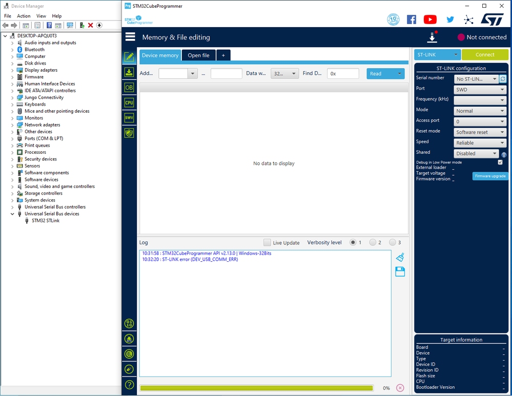

We brought new St-Link/V2,
Now I tested with STM32CubeProgrammer , In this we unable to read serial number of this St Link (some time it shows '@' symbol) . please check the attached the .png file
_legacyfs_online_stmicro_images_0693W00000dDHFAQA4.png Same issue we found in working ST-Link previously (after not detecting serial number shows 'A' Symbol)
Both cases it show in device manager.
May what is the issue ? Help me in this regards, it's urgent.

You are probably using a clone of the ST-LINK/V2.
Ways to recognise clones have already been discussed in detail in the Community, e.g. here ore there, meanwhile there is also a knowledgebase article on this, which you should please check.
