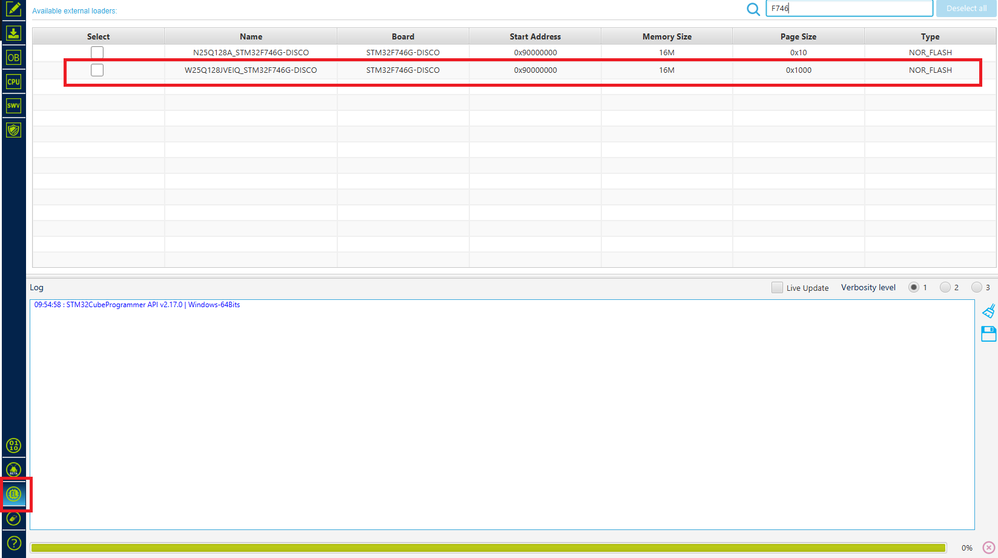

Why are you still using STLINK Utility? Please use STM32CubeProgrammer instead.
The ST-LINK Utilities have been deprecated for many years, there could be some issues with how the loader initializes or its size.
I should have some F7 W25Q128 loaders that work in this context.
I need only to add this on  STM32CubeProgrammer   ?
Why are you needing to copy the External loader? It's already available:

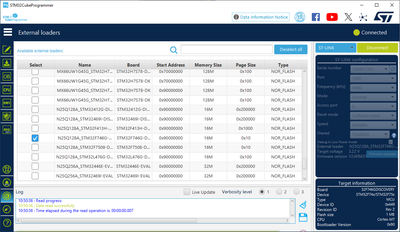

ok, I am using the STM32CubeProgrammer with External Loader but still not see the images stored on QSPI.
Soon I will update the log of flash phase
Did you succeed to Flash the external NOR flash with CubeProgrammer or not?
Be careful, there are two Flash loader as I shared previously, please select the correct one:
STM32F746G-DISO ver. B-04  with N25Q128A13EF840E
