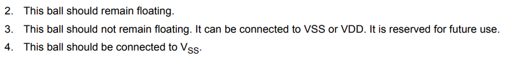

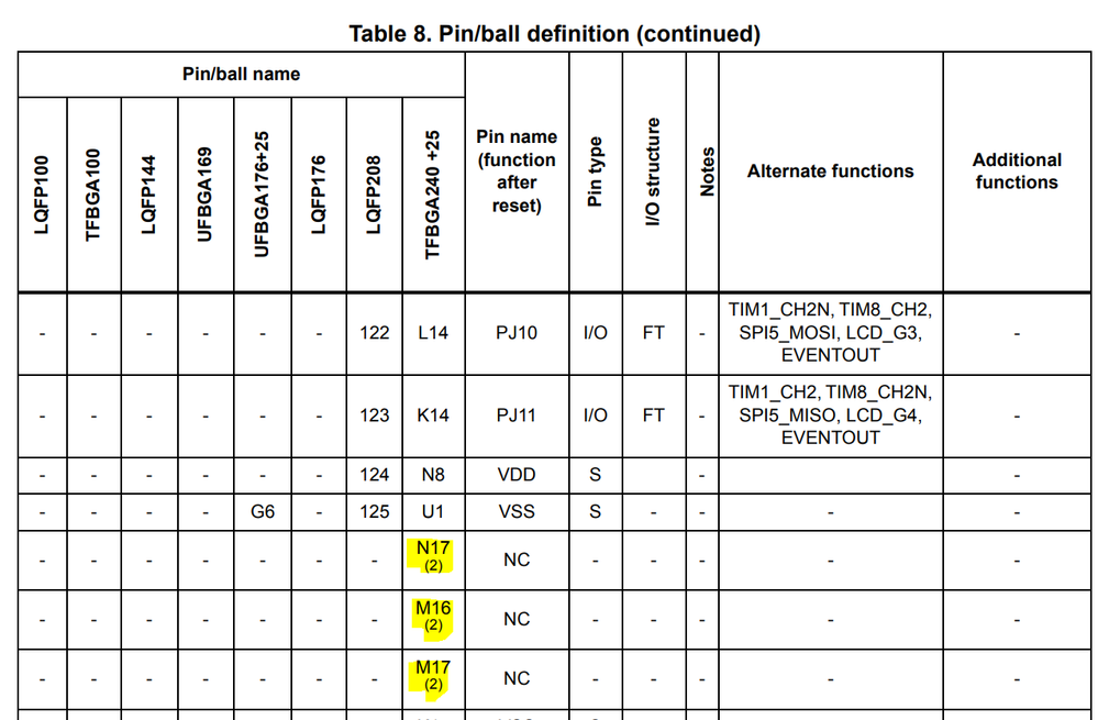

Should NC pins on STM32H753XI TFBGA240+25 be connected to ground, or can they be left floating?

It depends on the pin. Read the datasheet. Most should remain floating but some need connected to VSS or VDD.
