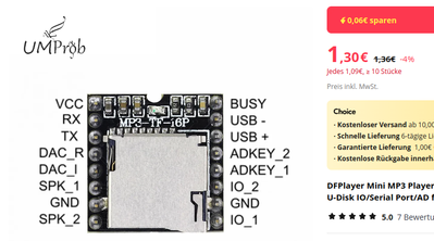

why not use the "standard mp3 module" , that can play mp3 ... ?
I don't want to use a uSD to store my file.... I prefer to use a external flash

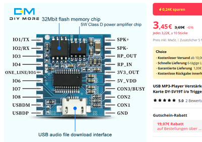

So take a module with flash... :)
