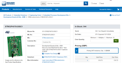

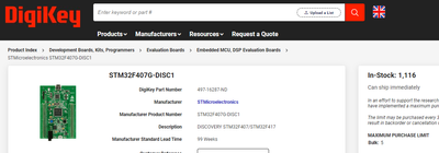

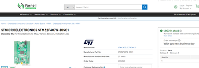

The STM32F407 DISCOVERY seems to be widely in stock:
