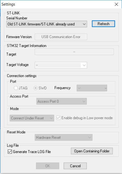

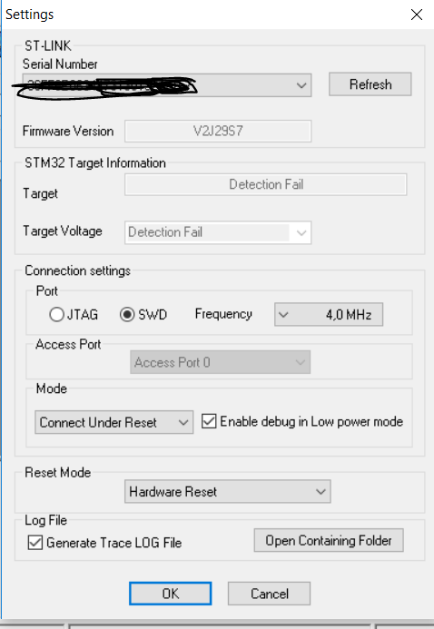

I'm trying to connect ST-Link/V2 ISOL using SWD to a STM32F030R8T6 without success using Utility.  When I go to Target -> Settings, the serial number is shown.
However, after pressing the Refresh button, Here's how I connected the debugger to the chip, this happens after a few seconds pause:
The error log shows this:
cErrLog::SetLogTraceOn
STLinkUSBDriver.dll loaded
USB communication error (65657) after target cmd F1 80 00 00 00 00 00 00 00 00
ST-Link get version failure
The detected STM32 firmware version (V0.J0) does not support the DAP read command.
W at 0xe0042004: 0x00000000
and the trace log shows this:
Target voltage detected: 2.855118
Error getting target IDCODE: if SWD, check SWD connection
Error (4) while initializing ST-Link in SWD mode
USB communication error (65567) after target cmd F2 45 00 00 FC 00 00 00 00 00
St-link                              Chip
Pin 1 - VDD                     VDD
Pin 7 - SWDIO                Pin 46 - SWDIO
Pin 9 - SWCLK               Pin 49 - SWCLK
Pin 19 - GND                  GND
I tried adding a pull-up resistor to SWDIO, a pull-down resistor to SWCLK, and a resistor from NRST to GND on the chip.  I've installed the latest driver from the website from LINK-009 and LINK-007.  Can anyone help me with this?
