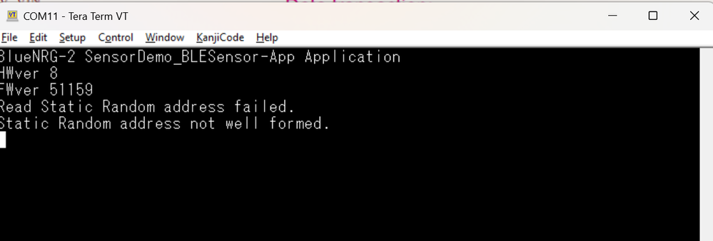

Hello, I am using the NUCLEO-WL55JC2 board with the X-NUCLEO-BNRG2A1 ble extension board. I run the SensorDemo_BLESensor demo code and I can detect my board in the BLE Sensor application In my phone. However, I want to connect a DHT11 temperature sensor but when I connect the VCC pin of the sensor to the +5V or +3V3 on CN6 connector of the extension board I can no longer detect the board in the application.
In the documentation, I see that that the pins are corresponding :
Do you have any idea of what the problem may be?
Thanks for your time

Hello, following your post here, it seems that you have solved the issue and can communicate with the BLE-Module with that board, would you share the configurations that you followed to make it work (Advertising) as I get the "Read Static Random address failed" error due to the configurations.
Thank you
