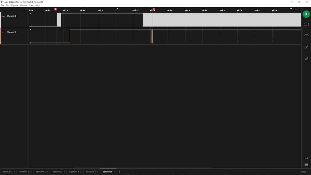

MFrie.6
I think now I am starting to understand the 2 second delay after I hooked up a logic analyzer:0693W00000WKEa6QAH.pngSo if I could just figure out how to delay the hse timeout it could work.

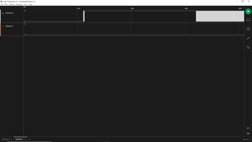

MFrie.6
That post was with basically a dumb usb power and this capture is a usb host:
0693W00000WKEhMQAX.pngThis one has about half a second delay

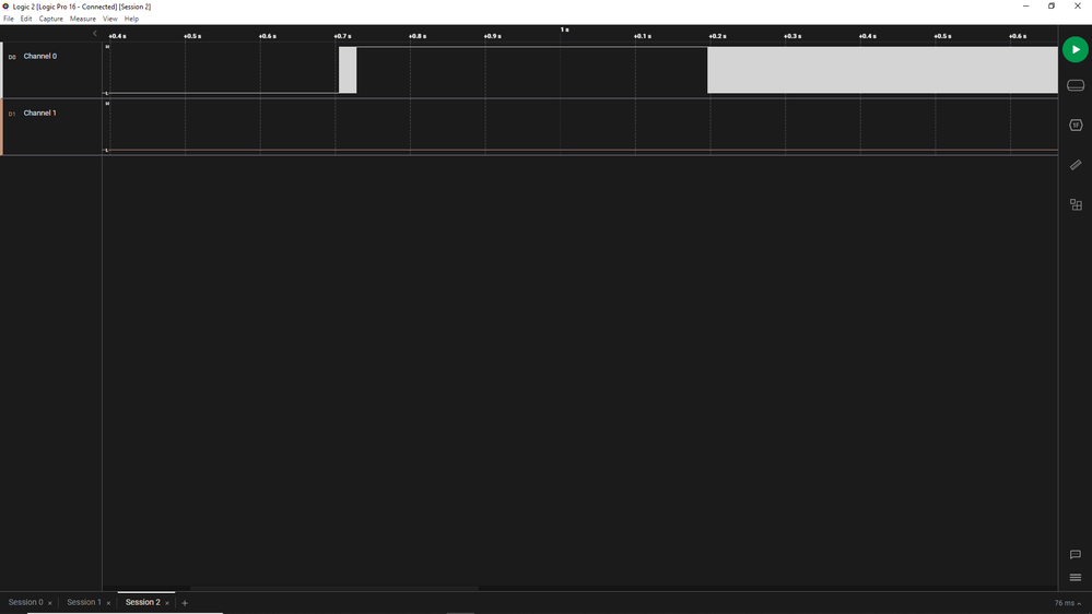

MFrie.6
So here is another capture. The CPU is getting reset after the ST-link starts sending a clock pulse. That doesn't make any sense to me then why it is not booting up. Any thoughts?0693W00000WKFKJQA5.png
MFrie.6
I figured out why it wasn't starting when it gets plugged in. You have to put
STARTUP_FROM_RESET
in preprocessor definitions. The catch with it is that you don't want to use it while debugging because the debugger doesn't have full controll with that enabled. I am using Crossworks for arm, so I don't know if it is the same for other IDEs. Now I just have to figure out how to power the st-link from the 5v pin.
