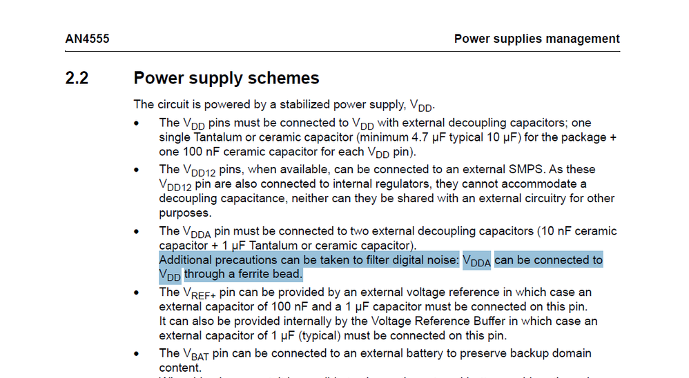

I am using STM32L412 Microcontroller in my current project.
As shown in the attached image in the Application Note "AN4555" for STM32L412,
For additional Precautions, VDD should be connected through Ferrite Bead at the VDDA pin.
So, my question is which Ferrite Bead should i use?
Can you suggest me the Part Number of Ferrite Bead?
Waiting for the Reply,
Thank you
