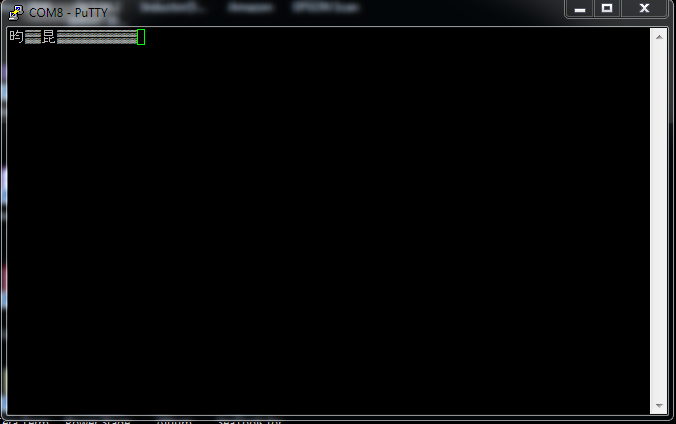

I have a Nucleo-H743ZI2 (MB1364C) board. From schematics it appears to me that UART3 is connected to STLink and can be used as a regular COM port ?
Is it possible to use UART3/VCP on the STLink as a regular serial port ?
Running Putty on COM8 STLink Virtual COM port, I get some chinese chars
Any idea, what's going on ?
Are those coming from the STLink firmware ?
The code that I am running on it:
Clocks/baud rate not what you want. Suspect you're going to need to unpack the register settings, and determine what you have. Scope the TX pins to measure bit timing achieved.
Attached code outputting at 115200 8N1, should prove the plumbing and terminal working.
Hi Clive,
Thanks for the quick reply and the help.
As you rightly said, the clocks issue and not setting the clock source.
These 2 changes helped.
#define APB_Div         4
LL_RCC_SetUSARTClockSource(LL_RCC_USART234578_CLKSOURCE_PCLK1);      /* Clk source */
Though that did the trick, still the question about the Chinese chars.
If I do comment out the clock source, I still do see the chinese chars.
Any thoughts ?

I did try a Google translate of the characters,
昀▒▒昆▒▒▒▒▒▒▒▒▒▒
Yún ▒▒kūn ▒▒▒▒▒▒▒▒▒▒
It seems to read as Yun and Kun ?? meaning Cloud and Earth/Universe ??
But still wonder where they come from ..

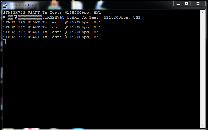

Is there an external pullup on that line? Line could be toggling due to noise or interference when the chip is in reset.
If you got those chars when your baud settings were incorrect then it's probably not from something your chip is doing.
I suppose the ST-Link chip could be creating those. Seems odd though.

My bad, it was not commenting out the clk source, that brought out those chars, but change to the baud rate with:
#define APB_Div         4
to
#define APB_Div         2
That clears up the issue, I guess ..
Thanks and sorry about the noise.
I would look at the binary values behind these, and perhaps the signal from the STM32 on a logic analyzer.
My guess is that the clocks are wrong, or the pll isn't locked/running properly, due to startup issues or inconsistencies.
Basically you're trying to translate line noise, at a different baud rate.
