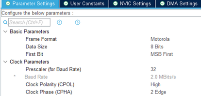

I am currently using the NUCLEO-H563ZI board to test SPI functionality.
I configured SPI1 as a master and was able to successfully transmit and receive data using HAL_SPI_TransmitReceive(). However, when I switched to SPI2, I found that the clock signal does not toggle at all, no matter what I try.
Is there anything specific that needs to be configured additionally for SPI2?
Below is my code; the rest was automatically generated by MX.

Do functions return HAL_OK? If so, probably the pin you are monitoring is not connected to the clock where you’re measuring. Check the board schematic.

It does return HAL_OK.
I am using PA12 as the SPI2 clock pin, and I am confident that I connected to the correct pin since the board silkscreen clearly labels it as PA12.

PA12 is not connected to the headers by default. You need to close some solder bridges. It is connected to USB. See the user manual or the schematic.
If it returns HAL_OK, the clock is working.

Thank you very much for your help. I had never considered that an EVB might have DNF pin headers.
I really appreciate your patience in explaining this to a beginner like me. Thanks again!
