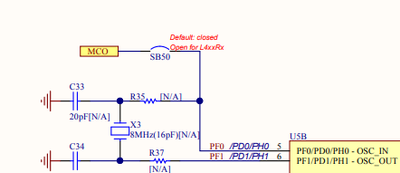

I am having trouble getting the USB peripheral recognized by the PC device manager.  In Cube I have the USB FS device checked, and the USB_DEVICE middleware set to virtual COM port.  Everything else is set to default.
The USB clock is set to 48MHz coming from the HSI48 source.
When the peripheral is connected to a PC (through a HUB) the device manager refreshes but the VCOM port does not show.
Thanks for the help.
Brian

No problem - the 8MHz clk coming from the st-link onboard Nucleo-F072RB :
So it will run with HSE (8MHz) setting, set it to bypass:

I also confirmed that the HSE 8MHz clock was set to bypass and SB50 is installed.

I have also tried to use HSI48 input to USB along with CRS SYNC enabled without success.
Do we have any other thoughts?  I did order a crystal to try, I have tried just about every clock combination I can in Cube.
