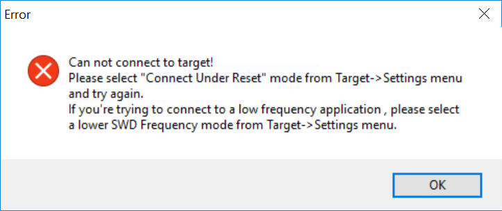

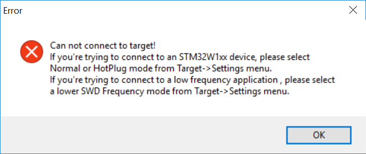

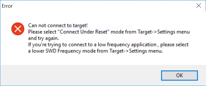

Aha, it does the same thing with ST-LINK/v2.
If I select the ''Connect Under Reset'' I get the second error pop-up.

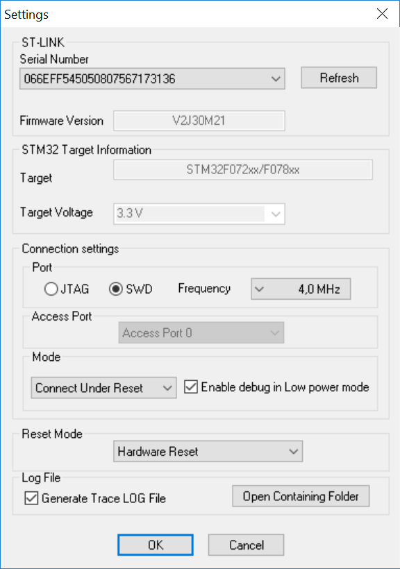

This is how it looks with embedded debug interface (USB) with updated firmware.
