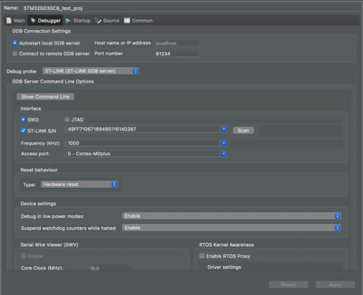

No Target Device found.
patliputram
Dear ST community member,
I am new to ST platform.
I am using STM32G030C8T6 Development board from 7 Semi and ST Link V2.
Dev board link: https://evelta.com/7semi-stm32g030c8t6-arm-stm32-mini-development-board/?srsltid=AfmBOorI6XBlJ_AMXNVV184OhO-lB02AFODj1611j8H62qR2M0FZkmF9
Connection:
  • dev board USB: power
  • dev board RST: NSRT or pin15 of ST LINK V2
  • dev board SWDIO: pin 7 of ST LINK V2
  • dev board GND: pin8 of ST LINK V2
  • dev board SWDCLK: pin9 of ST LINK V2
  • dev board 3.3: Not connected
Please guide me where I am doing wrong.
Thanks in advance
Regards,
Anand Sagar
>using ST LInk V2
Which one : like a stick , or original , like small box ? (original: need connect 3v3 )
Use CubeProgrammer , connect (set: software reset), show pic, what its telling.

I am using ST LInk V2, not IOSL, and providing power suing type C USB connector.
also validated the pins connection, all are fine.
>using ST LInk V2
I am using original ST LINK V2 from st.com, yes after connecting the 3V3 to pin 1 of the ST Link, started working with default debug settings.
