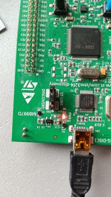

One of the possibility is that the board is not powered properly. So check the jumpers on the board make sure it gets power from the cable. The jumper should be on ST-LINK.
Assuming this is the jumper you mean, it seems in order.
I checked multiple cables, none worked on the main system, and the debug pins are free too. As everything works on my work laptop, that's where I continued my work for now, and the exact same cable works on the laptop too.
Hitting reset button didn't help either.
