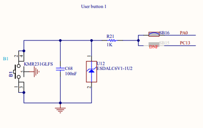

And how is the Button wired? Pull-up to VCC, button pressed to GND ?
Not sure the MCP2515 uses an open-collector output, or can be configured from a driver, level or pulse sense. Sure the Data Sheet would elucidate.
Use EXTI0
Use a scope and confirm behaviour and expectations
‎2024-06-17 9:34 AM - edited ‎2024-06-17 9:34 AM
Here's the schematic of BUT1 pin. I'm not sure if the PA0 bypasses this connection, or if would only work if the button is pressed
‎2024-06-17 9:46 AM
Ok, so NUCLEO-WL55JC(1) board
You could remove the solder-bridge (SB16) or link, or move to PC13 (SB15) if nothing else conflicts, and use the EXTI15_9
That would free PA0 for your own, personal use, on the MORPHO connection/headers
‎2024-06-17 9:58 AM
Ok, so if I just remove the SB16 solder, the PA0 pin would be available to use on the MORPHO connectors, or simply just use the PC13 pin, right?

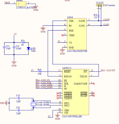

Hey, just updating.
I changed, the pin I was using for the interrupt. It is connected directly to the interrupt MCP2515 IC pin. I pu the osciloscope on the pin, and couldn't see nothing, only a voltage offset.
What could it be? I need to do something else?
‎2024-06-25 8:30 PM
Have you programmed the mcp registers to generate interrupt. If you post the code we can analyse

‎2024-06-26 6:29 PM
Ad per datasheet the int pin can be configured for different purposes. Are you using any breakout, then check the jumpers. I guess it needs pullups
‎2024-06-26 7:34 PM
Also don't know, here's the schematic on the board (consider PA0 as PB14 (CAN_INT_Pin))
