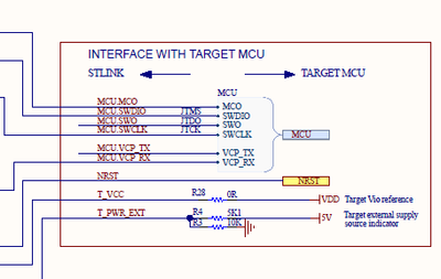

I am trying to make some very low current (<1uA) power measurements on the MCU on the STM32U083C-DK demo board.
I see that jumper `JP7` is provided specifically for this purpose, but I am concerned that connections from the MCU to the STLINK interface might leak current and throw off these measurements- especially when testing with MCU Vcc voltages that differ from the STLINK supply voltage.
Is this a valid concern, or are those connections equivalent to air-gapped when the MCU is normally running?

Probably, perhaps also look at the CAD files, see if there's anything that can export a Net List.
You might be able to mitigate somewhat by switching the pins here into an analogue input / tri-state. I'd suggest initiating that as a console/monitor command to the system, rather than at start-up, such that recovery and reprogramming is kept workable rather than immediately thwarted.

2.3 "Ensuring accurate power measurement"
Trying to measure current consumption in the nA low-power modes of ST is quite a specialized thing. I suggest you open an online support ticket on ST OLS to get help directly from them.
Alternatively, ST offers the ST-LINK-V3PWR  specifically for doing these sorts of power measurements. Perhaps that would save you from the thorny job of chasing down multiple and subtle error sources, which would be required for such a difficult measurement.

Yes - absolutely!
You really need to scour the schematics for all possible leakage paths - the documentation doesn't necessarily cover them all.

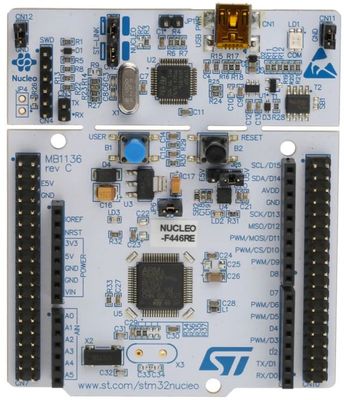

This is a reason I dislike such boards crammed with "extras" - too often they just get in the way!
There seem to be a couple of Nucleo boards for this processor:
https://www.st.com/en/microcontrollers-microprocessors/stm32u083mc.html#tools-software
https://www.st.com/en/evaluation-tools/nucleo-u031r8.html
https://www.st.com/en/evaluation-tools/nucleo-u083rc.html
Unfortunately don't seem to be ones where you can break off the ST-Link, but at least they have less stuff on them!

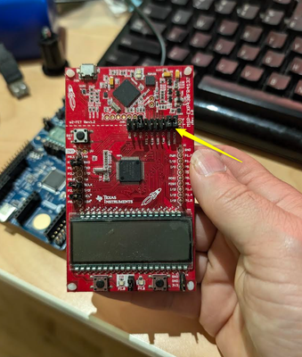

TI does a nice job of putting a DMZ between the debugger/programmer and the MCU and adding jumpers on every line that crosses the DMZ so you can visually verify air-gap for evaluation.
If anyone at ST is listening, this would be a great feature on future boards. :)
NUCLEO-F446RE
