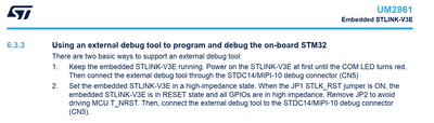

Does these boards work out of the box with an external debugger like a J-Link Ultra+?  I see they both support a MIPI10 connector (and one supports a tag connector as well) that leads me to believe it supports an external debugger.  However, I can't find any information about connecting these newer boards including jumper configuration changes.  The newer boards with ST-LINK/V3 don't support flashing to JLink-OB.
I'm primarily interested in more break points and trying to use advanced features of that debugger.

AScha.3
for U5 nucleo144  board, see user manual:
