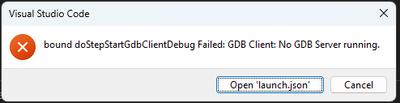

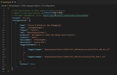

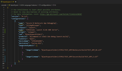

With the new STM32Cube Debug Jlink GDB Server V1.2.0 I'm not anymore able to start the debugging session. If I downgrade to V1.1.0 then it is working again. I get always the error message "No GDB Server running". I tried that with my old launch.json settings and with the new generated and adapted json settings.
  • Do I miss some special settings or has the new extension a bug?
  • Or do i need any dependency?
error message:
 old launch.json
 new launch.json

To client: {"seq":0,"type":"response","request_seq":2,"command":"launch","success":false,"message":"bound doStepStartGdbClientDebug Failed: GDB Client: No GDB Server running.","body":{"error":{"id":1,"format":"bound doStepStartGdbClientDebug Failed: GDB Client: No GDB Server running.","showUser":true}}}

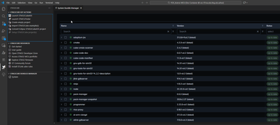

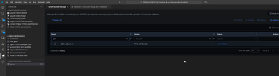

Then I checked the version, there I saw that the jlink-gdbserver was not installed. Then I installed the gdbserver
 Log after installation of jlink-gdbserver and reloaded window

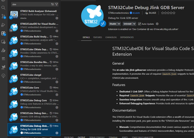

For me it's strange that the jlink-gdbserver was not installed, but the gdb-jlink extension was installed.
Any clue what happens?

The STM32Cube Debug J-Link Gdb Server extension contains the implementation of our Debug Adapter Protocol (DAP) for J-Link as well as the JSON schema for the jlinkgdbtarget debug configuration.
The extension does not include the J-Link gdb server binary. That binary is included in the associated bundle. This allows you to have multiple versions of J-Link gdb server installed on your machine (visible from the bundles manager). So maybe version 9.14 was not installed, but another version was.

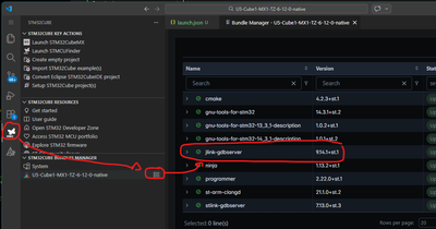

  • I see in your screenshots, in the bundles manager view, you only have access to the "system" and not the "project" bundle manager (see my screenshot in my first post). Maybe the project had not yet been imported into VSCode at the time of your screenshots?
  • Please check the bundle manager on the project, because that's where you can see which version has been "locked" and is being used for this project. (if an old version is locked, please try to lock the latest installed)

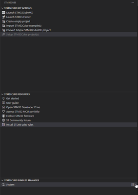

The project setup did not complete successfully. You can redo it by using "Setup STM32Cube projects" in the STM32Cube Key Actions view.

I can not do a project setup, that is in my case greyed out. Why is that not possible? The project is from .ioc generated with the cmake option selected.
