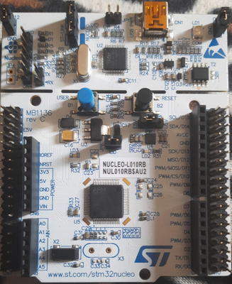

I have a problem in my project involving the STM32L010RB MCU and the HC05 Bluetooth module.
Currently, the system operates smoothly when connected to the USB port. The HC05 Bluetooth module successfully performs its data transmission and reception tasks without any hitches. However, upon introducing an external battery and jumpering pins 2 and 3 on JP5 to provide the Bluetooth module with a 5-volt supply, the module appears to power up correctly, as indicated by the LED, but fails to transmit or receive any data.
I have thoroughly reviewed the connections and power supply, but I have been unable to identify the root cause of this issue.

Mike_ST
Hello
What board is it ?
Is it a custom board or a Nucleo ?
Board Nucleo-L010RB

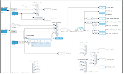

We used LPUART in our project.
Also we used 2 lithium batteries connected in series each 3.7 volts.

@Minaihab wrote:
I measured the voltage across the module's supply pin, and it was 4.7 volts.
That's not what I asked.
You need to look at it with an oscilloscope to see if it is steady.
Your photo shows only the Nucleo board - we need to see how the battery and the HC05 are connected.
