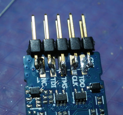

Is it OK to Solder 0.1 inch connector pins on ST-LinkV3MiniE PCB edge connector?
David_
Senior
V3MiniE is 2mm pitch, total 10mm at outer most gold finger pcb trace.   Two rows of  5 pins 2.54mm pins is 10.16mm at centre, for top an dbottom gold finger.  It will work ok, right?  TIA
AScha.3
Sure, if you center the "wrong" as good as possible and can solder, without making a short to next pin.
Especially the 1. and 5. are no more on the copper trace, but only thick solder joint can bridge the gap here;
but if you  can do this - its ok.
It could look like mine here :  :)

Many thanks
