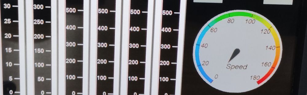

S.sin.1
Your custom board require custom BSP for your touch and lcd init...could you please explain How to customize BSP...
Already  made the required changes to file  STM32TouchController.cpp & stm32h745i_touchcontroller.cpp file attached.
 Already mentioned in my first query that the real display is working fine can display text blocks, box, analog meter. display is working fine its totally in my control.  1000029894.jpgHaving trouble with touch integration only.
