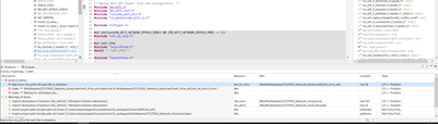

Hello ST community,
I'm trying to implement a Wi-Fi solution on  STM32U5 series (B-U585I-IOT02A) from the CubeIDE example "IOT_HTTP_SERVER".
I face problems when I copy dependencies like Drivers and Middlewares because it does not include right paths.
I tryied differents ways to include headers without success.
I tried adding path manually using :
- Absolute paths
- Relative paths (../../file.h) or (../file.h)
- Adding folder to the path searching in STM32 CubeIDE or in files browser.
To visualize it, here is the example includes and my project includes.
Thank you in advance.

AI_STM
fatal error : mx_wifi.h: No such file or director
I added the includes paths as you said but it is missing the parent repertory between workspace and Drivers.
Has to be an error somewhere.
Show screenshots of the relevant configuration pages and of the file existing in said directly in windows explorer, and the relevant #include statements.
AI_STM
Includes
Paths & symbols
Errors
