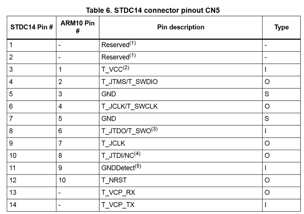

Thankyou everyone for the kind replies,I'll narrow things down,these are the connections for the STDC14 for STLINK-V3MINI,I wanted to ask which pins are actually going to be used for programming/debugging the stm32h7 chip ,for example in stm32f1 i could use the pins from 4 to 7 to program it ,Is it the same for stm32h7,Im sorry if this is not a reasonable question but im just trying to keep it simple,I could have bought the V3SET but Im also on a budget ,plus I also found out that you could debug/program external stm32 with the dev board .
‎2020-08-13 6:00 AM
For debugging with SWD, you absolutely need the SWDIO, SWCLK and GND pins. Optional but recommended would be NRST, SWO, and VCC.
The VCP_RX/TX are useful if you want to use a UART stream for debugging.
