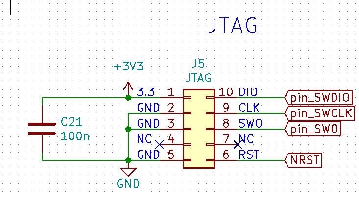

For a project, I created a PCB with an STM32F411 using a 10pin JTAG port for SWD programming.0693W00000HoWkxQAF.pngI tried to connect my card using the ST LINK V2 box and the ST Link utility software but I get the following error:

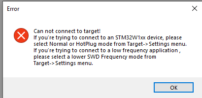

0693W00000HoWeWQAV.pngThe st link works because I can program another card using a stm32F042. I tried all the connection parameters and to play with the BOOT0 pin status but nothing works.
Can anyone help me to program my card?

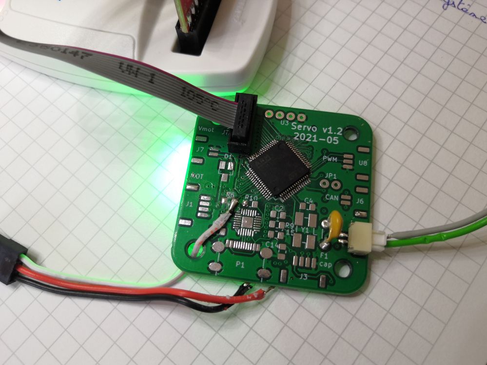

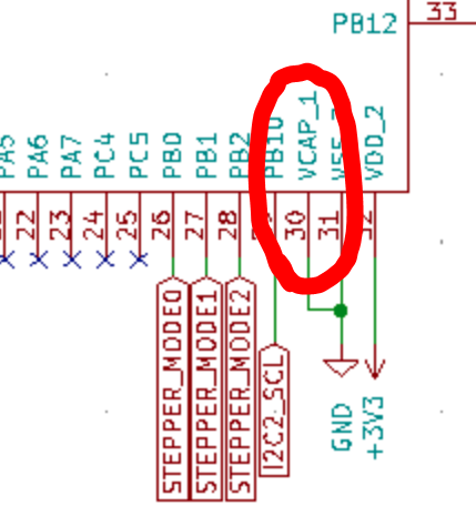

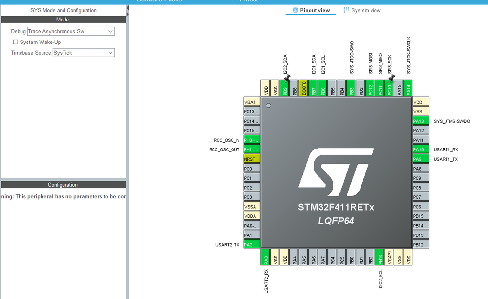

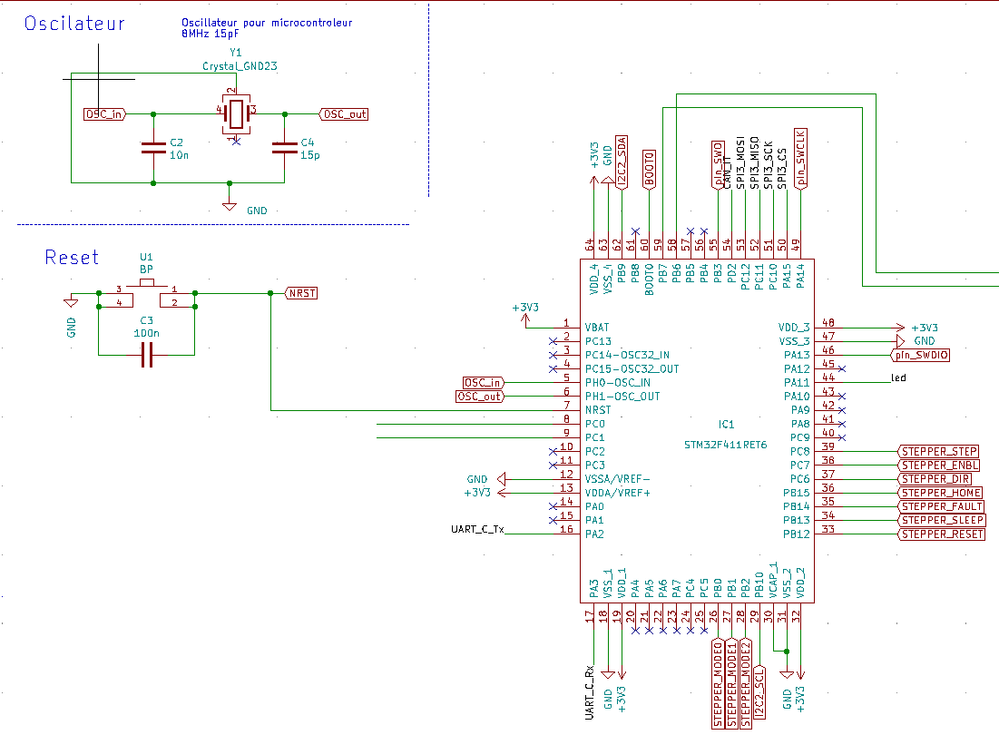

Here is a part of my wiring diagram, the stm32 CubeIDE configuration and a picture of the board. Pin 1 is on the bottom right. BOOT0 is given to a 10k Ohm resistor for which I can choose to ground or 3.3V
You've grounded VCAP. That will cause the chip to not function. This pin outputs ~1.2V and needs to be bypassed to GND with a ~2.2uF cap.
Review the reference layout documentation.

Sorry I didn't see this feature in the documentation. I unsoldered this pin and soldered a 2.2uF capacitor as indicated. Now the card consumes much less and the value seems to me more coherent (10mA instead of 150mA).

After looking at your picture again, the only thing you have populated is the STM32 and F1 and some cables. Might need some decoupling caps on there before it acts correctly. I guess there may be components on the other side.
Yes, I will order a new card changing the Vcap pin and putting a 4.7uF capacitance (because only one Vcap if I understood) and putting all the decoupling capacitance requested for the power supply. Yes I have components on the other side, and the board is printed on 4 layers.
