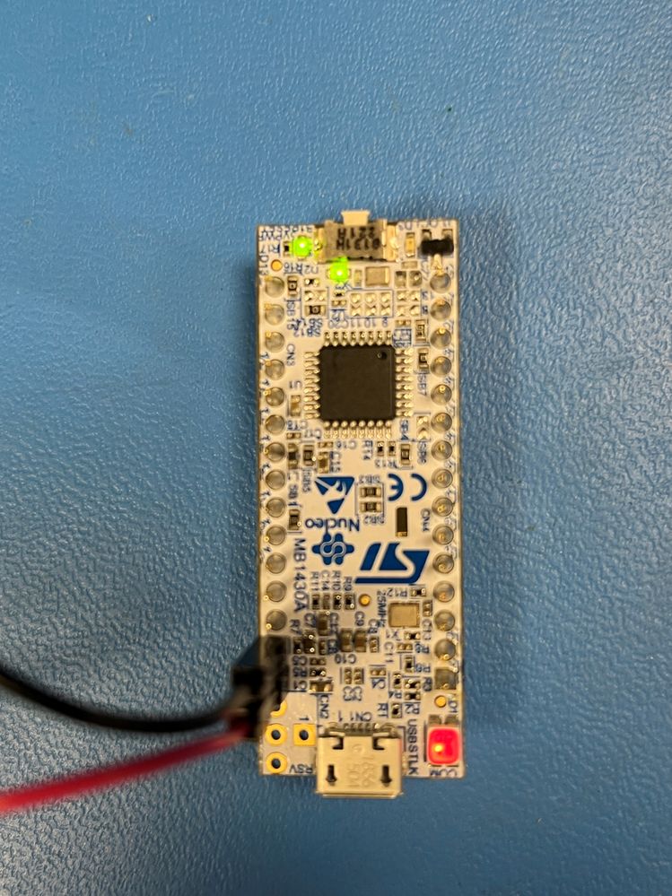

For all board a general rule if the main STM32 does not start as indicated to you the root cause comes from the nRST pin which is pulled to the VSS by the onboard STM32 STLink.
Some Nucleo64 and 32 boards are equipped with jumper allowing this nRST signal to be isolated in order to avoid this.
But in the case of a NucleoG431KB (Nucleo32) the STLinkV3 solve this problem.
I just did a test with this board. The onboard STLinkV3 is V3J2M1 firmware version.
By applying a 12V on CN3.1, the STM32G431KB boots and works as expected.
Can you check the STLinkV3 firmware version and upgrade it ?

The STLink version is V3J10M3 -- Not sure if this is newer or older? Is there anywhere V3J2M1 can be downloaded? Currently observing that upon startup, The STM32G431KB doesn't boot up if the USB isn't connected. Upon connecting the USB, it runs as expected.
RomainR.
Yes firmware V3J10M3 is is one of the latest version, to upgrade to the very last one, use STM32CubeIDE -> Help -> STLink Upgrade to update to V3J11M3.
I've tested on my NucleoG431KB and the G431 boot and run with V3J10M3 and also V3J11M3 (picture below shows LD4 On, LD2 blinking by firmware and LD1 blinking red slowly because USB is not connected)
_legacyfs_online_stmicro_images_0693W00000biYxmQAE.pngWithout USB connected, can you check nRST ? Is it high ?
Does LD4 is on when applying 12V on CN3.1 and GND on CN3.2 ?
