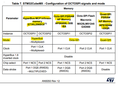

OSPI_RegularCmdTypeDef in stm32l4xx_hal_ospi.h doesn't include ".LatencyMode" member as below.
how to set variable latency or fixed latency for Octo-SPI PSRAM on STM32L4P5G-DK board?
Thanks.

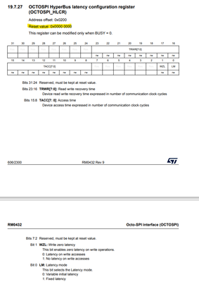

To clarify my last reply, the latency is not available when Octo-SPI or Quad-SPI mode is selected. Because the latency is supported with hyperBus protocol. The latency can be configured via the OCTOSPI HyperBus latency configuration register (OCTOSPI_HLCR). The reset value is 0x0000 0000.

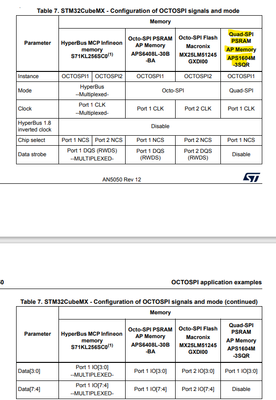

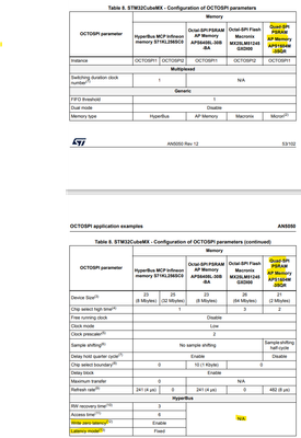

->The AN5050 defines the latency mode for octal-spi PSRAM as "N/A". So, how can I know the default mode?
In AN5050, the mode using with PSRAM APS1604M-3SQR is the Quad-SPI mode and the mode using with PSRAM APS6408L-30B-BA is Octo-SPI mode.
You can choose the mode depending on memory datasheet.

The latency is supported with hyperBus protocol as mentioned in reference manual section 19.4.5 HyperBus protocol.
To configure the PSRAM on STM32L4P5G-DK board, I recommend you to follow AN5050 section 7 OCTOSPI application examples.
