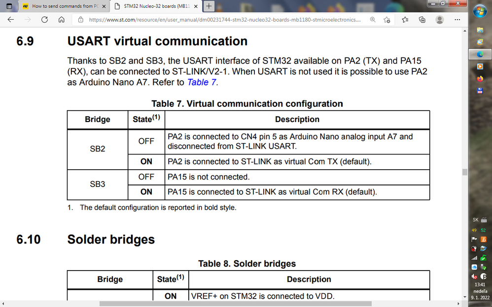

I'm using a Nucleo board, specifically the L031K6. I'm used to sending UART messages from the board to the PC via the ST-Link USB interface. In this project I wanted to do the other direction going from the PC up to the card over the same interface.
The problem is I keep receiving data on the PC but I couldn't receive any data on the card although I tried different serial terminals.

As describe Nucleo pdf you need config ...

I did create the code, with 3 scenarios, Polling, DMA and interruptions, and all of them didn't work when I send data to the board over the ST-Link (i.e over COM port in my PC)
Maybe I was not clear, I did succeed in having the solution with an external USB to UART circuit (FTDI) that is connected to UART pins on the Nucleo. My problem is that I do not want to use another external circuit, but rather the ST-Link for both directions (Nucleo -> PC which is working, PC -> Nucleo which isn't working)
Mike.BK
Thank you, this solved the problem.
I used PA2 and PA3 instead of PA15 and that's why I can send but can't receive.
