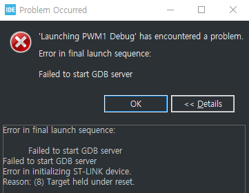

Hello.
I am a STM32F407VE user.
I am trying to load a program using ST LINK V2, but an error occurred and the program could not be loaded. The error is as follows, and if there is anyone who can solve this error, please let me know. thank you.

A custom board?
What are you doing with VDDA ?
Is NRST clamped low? Can you scope/measure it?
