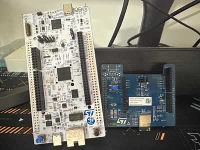

How to connect nucleo-h7s3l8 and x-nucleo-67w61 ?
hedejiang
nucleo-h7s3l8   x-nucleo-67w61
I don't know how to connect them.
Could you please show it in pictures?
Thank you.
Imen.D
Hello @hedejiang ,
The X-NUCLEO-67W61M1 board is connected to the NUCLEO host board via the Arduino connectors:
  • The 5V, 3V3, GND through the CN6
  • The SPI (CLK, MOSI, MISO), SPI_CS and USER_BUTTON signals through the CN5
  • The BOOT, CHIP_EN, SPI_RDY and UART TX/RX signals through the CN9
You can find more details on the ST wiki page: ST67W611M Wi-Fi®– CLI Project - stm32mcu
This package may help you on your working project: https://github.com/STMicroelectronics/x-cube-st67w61/tree/main/Projects/NUCLEO-H7S3L8
Thanks
Imen
