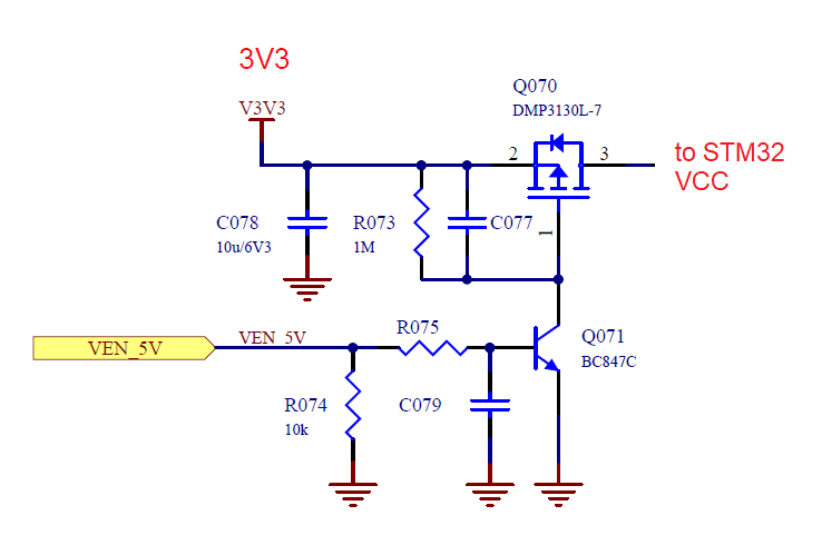

Which Pin should I set and reset to make a power cycle happen in STM3G4 or any popular STM32F3xxx.. ??
I have 2 mcu's and with one of it I want to do a power cycle..
I mean to remove the power and connect it again. What should I do here?

Then you need some more hardware, most importantly a P-channel MOSFET.
Something like this, although when switching 3V with 3V IOs you can leave the npn.
