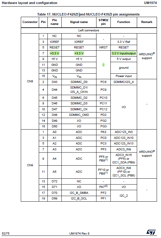

Hi all, i am using a STM32 Nucleo-144 developement board with the STM32F429ZI MCU and i am powering it with a 5V Battery. In the Datasheet it says that Pin7 is a 3.3V output. Can i use this Pin to power a Sensor?

That pin seems like the one connected to the NUCLEO board 3v3 regulator´s output.
How much current requires your sensor?
The nucleo regulator seems to be LD39050PU33R with a max current output of 500ma

According to the datasheet it needs 30 mA
Go for it
